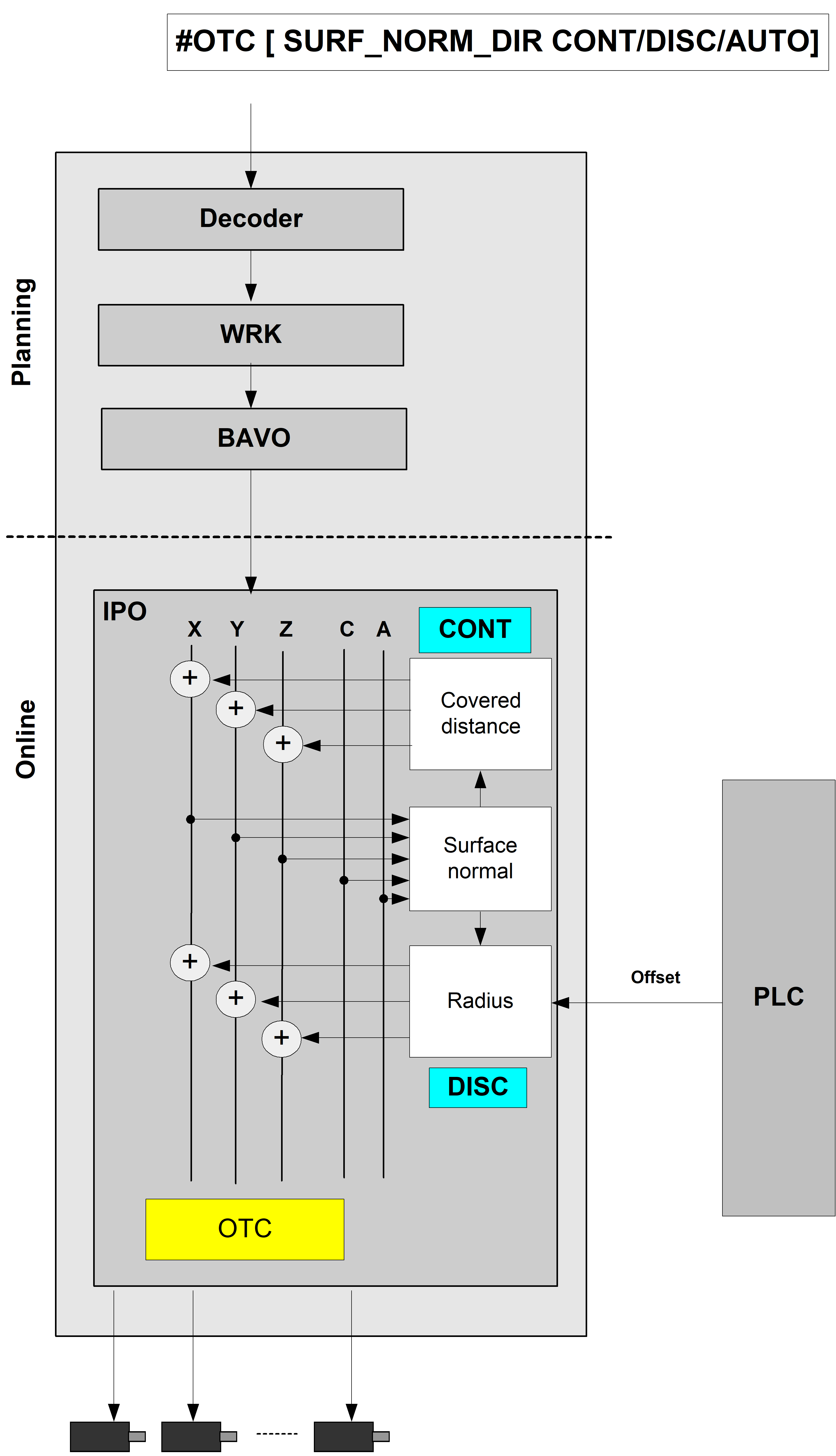

This compensation type compensates for wear in surface normal direction. The surface normal direction is calculated in the CNC based on the tool direction vector and the path tangent vector.
Wear compensation in direction of surface normal 1:
Wear in surface normal direction

Wear compensation in direction of surface normal 2:
Description of SURF_NORM_DIR function
