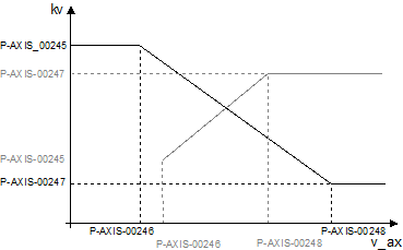

Settings for dynamic kv adjustment (getriebe[i].dyn_kv.*)
With dynamic 'kv' adjustment the position controller gain can be altered dependent on the axis velocity.
The required position control loop gain for two axis velocities must be defined. Position loop gain is linear interpolated between these two velocities. The figure below shows some examples of dependencies between position control loop gain and axis velocity.
![Settings for dynamic kv adjustment (getriebe[i].dyn_kv.*) 1:](Images/png/117790219__Web.png)
