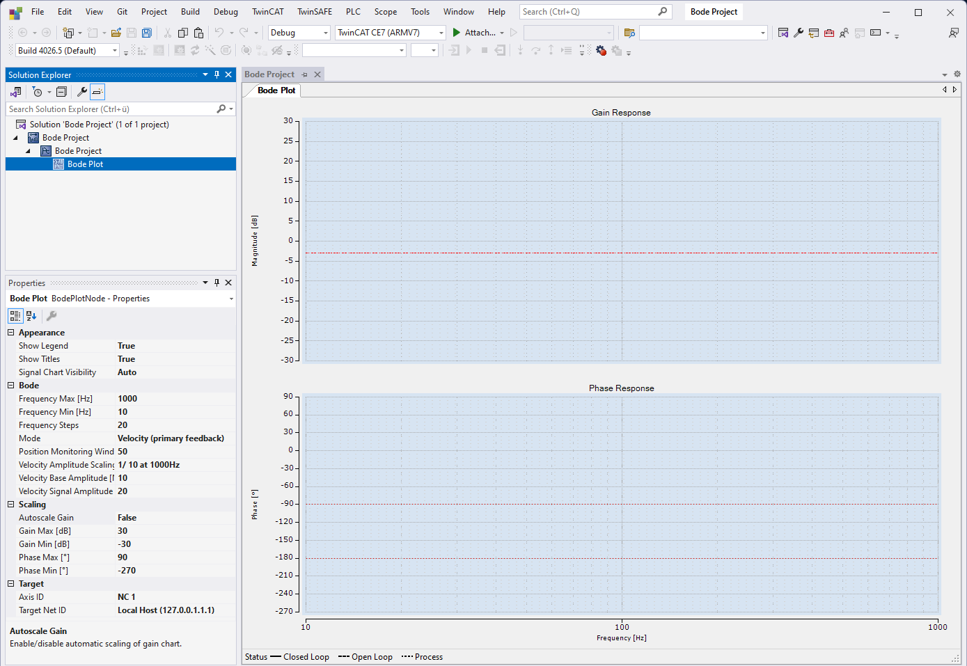

3. New project
Open a new Visual Studio project in one of the installed versions via the context menu of the TwinCAT tray icon.

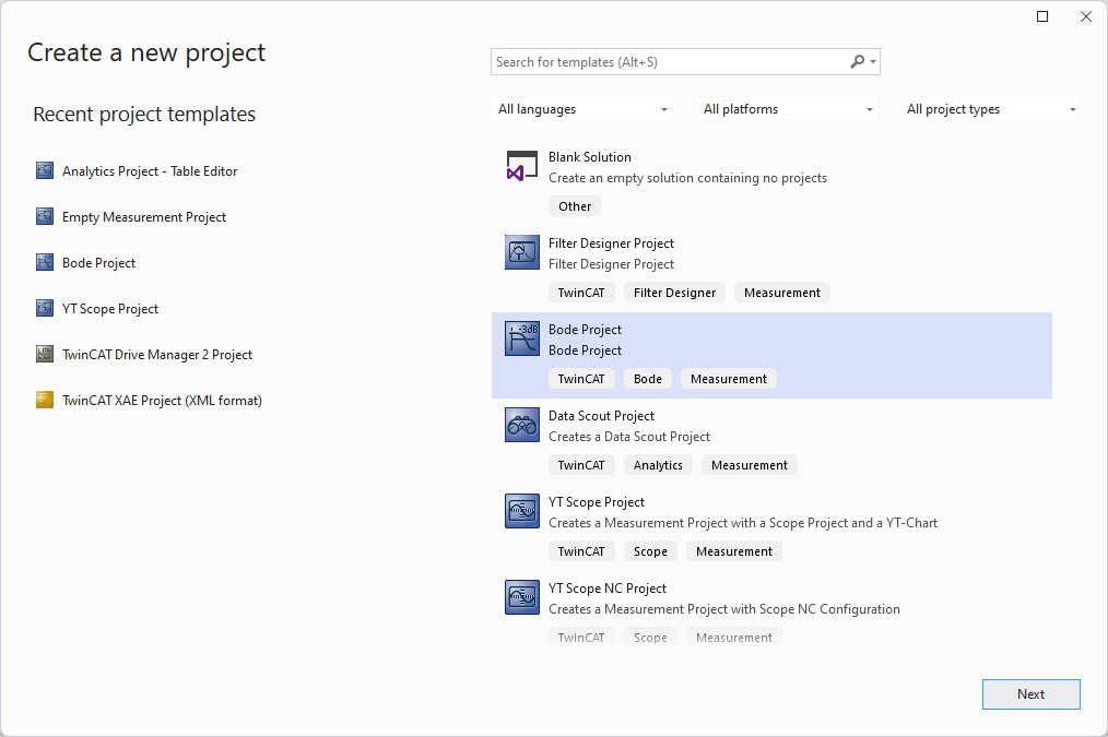

A new Visual Studio window opens. Create a new Measurement project via the TwinCAT 3 start page or via the File menu.
A window opens showing the existing Measurement templates. Select the already pre-configured Bode Plot here.
A solution with a project tree opens in the Solution Explorer. You can find the Bode Plot at the lowest level.
In the Properties window, set the "Axis ID" and "Target Net ID" for the drive axis with which the Bode Plot is to be created.

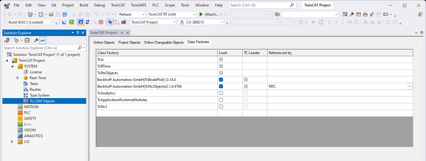

Announce the TcNcObjects Class Factory: the Bode Plot is executed by a TcCom object in the TwinCAT system. To ensure that this can be generated automatically from the Bode project, you must announce the Class Factory for TcNcObjects.

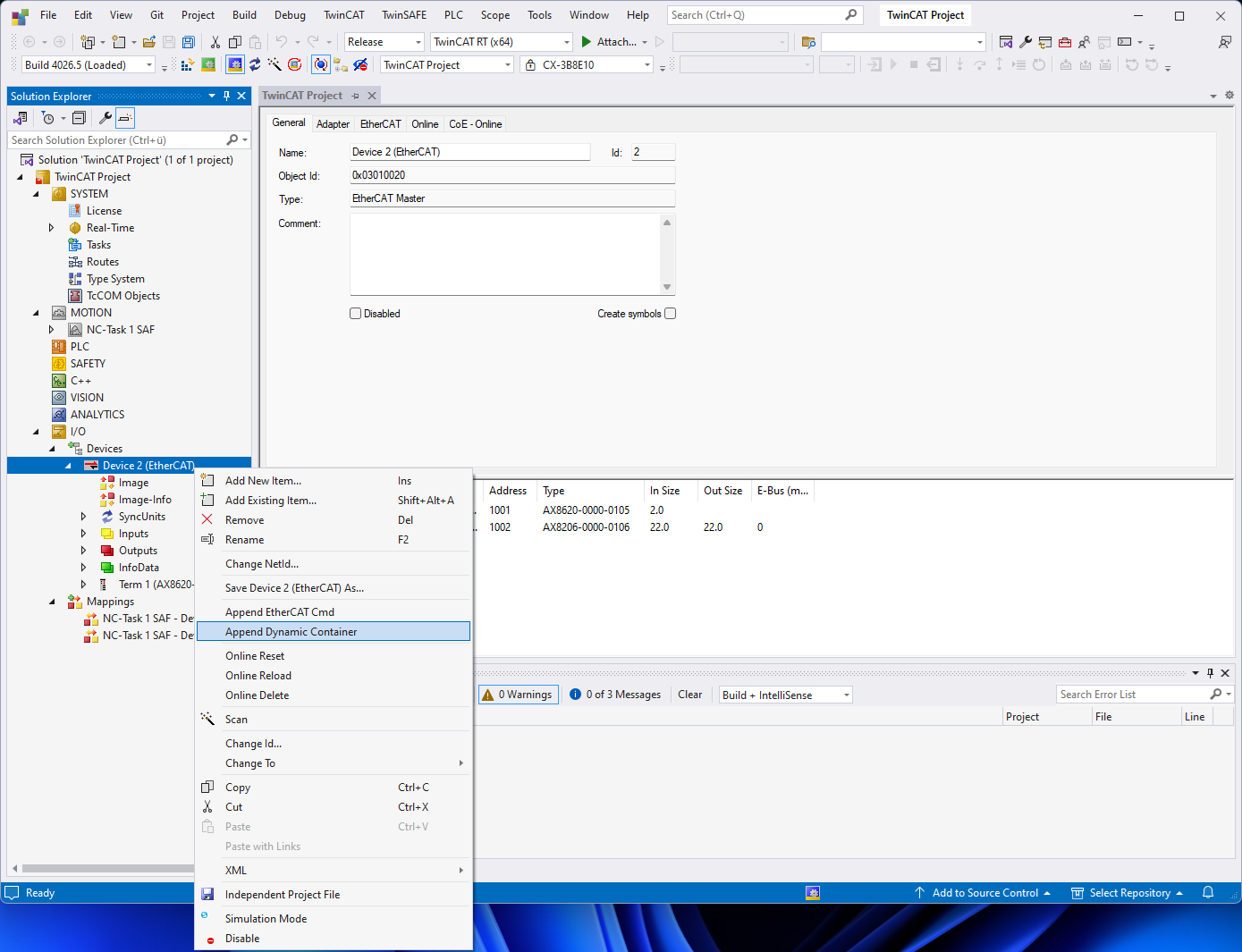

Append dynamic containers to the EtherCAT master: for dynamic communication with the drive, reserve a memory range once only per EtherCAT device. Confirm the subsequent dialog for querying the container size with OK.

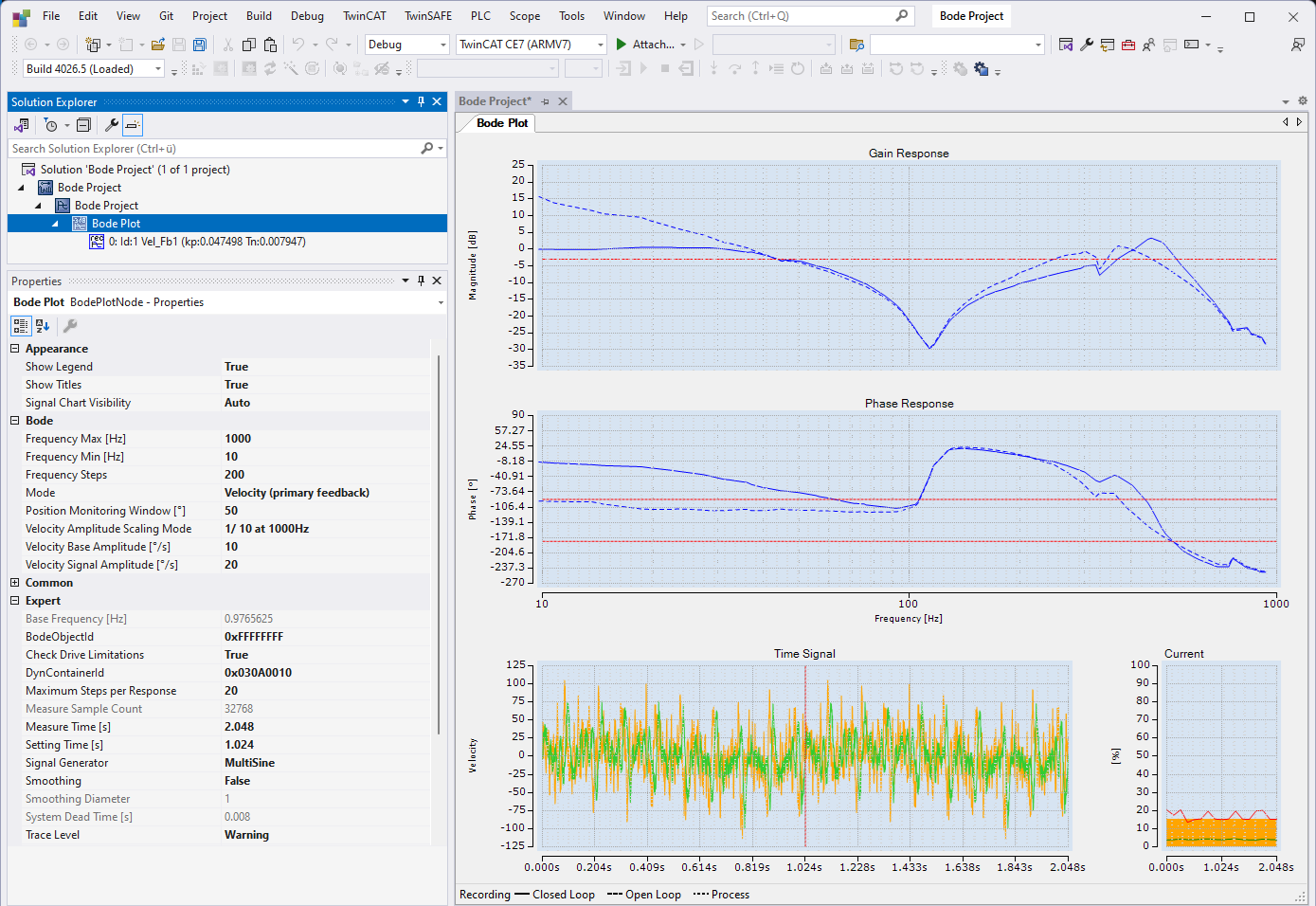

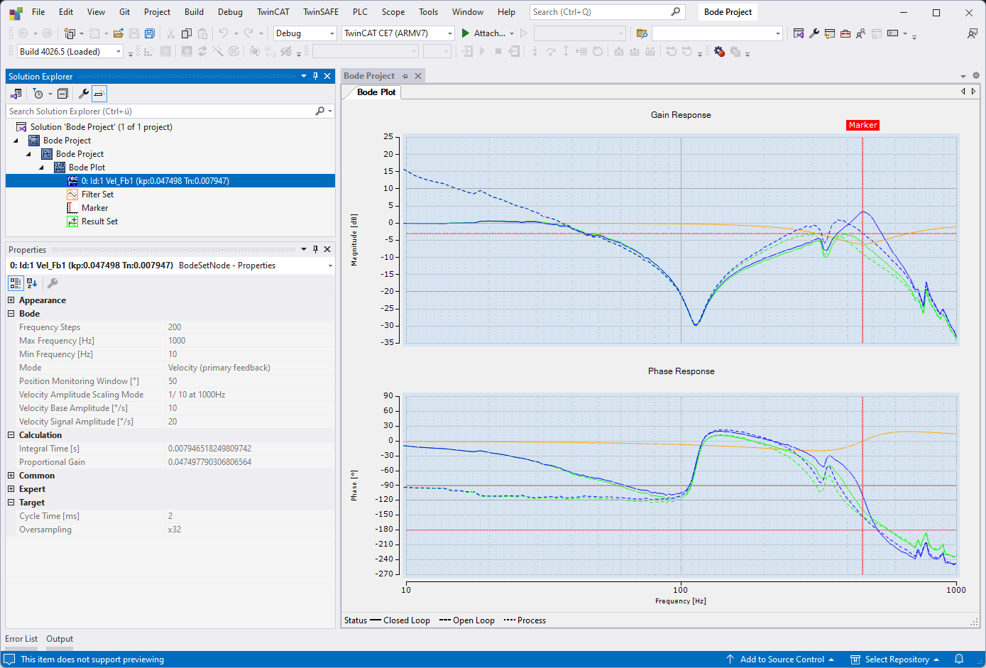

After having selected the target system and the drive axis, you can parameterize the recording in the Plot properties. The details for the plot settings can be found in the section "Bode Plot - Plot properties". The Bode Plot is started with the "Start Record" button in the Measurement toolbar. During the recording the current time signals are displayed below in the plot. You can abort the recording at any time with the Stop button.

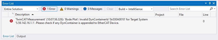

6. Error
If errors should occur during the recording, they are displayed in the Visual Studio error list. For example, the Bode Plot signals a missing axis release when trying to start the recording.
However, the error list only displays the errors output by projects that are part of the active solution.
Example: If a lag error is signaled for the drive axis and the project is not part of the active solution, a general Bode Plot error is output.
If the project is part of the active solution, then the lag error is also output in the error list.
7. Analysis
Following the recording you can see all the characteristic curves created so far. You can change the display options in the properties. For example, it may be useful to view the "path" as well as the "open control loop" and "closed control loop", or to highlight or mask individual characteristic curves. Details for the settings can be found in the section "Bode Plot - Set properties".
Beyond that you can also append filter sets for the simulation of filters or result sets for the determination of overlapping results.
