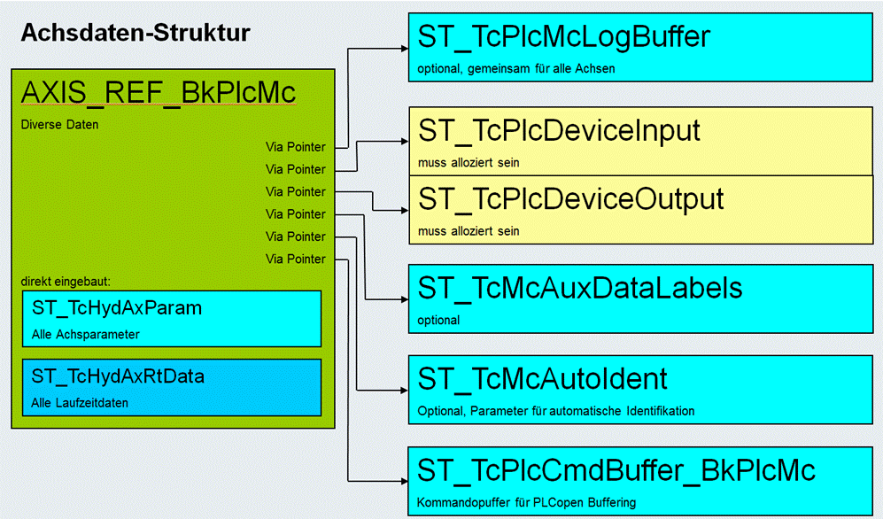

Structure of the documentation
Each axis consists of an axis structure under the name "Axis_ref_BkPlcMc", which is composed of different external structures. This axis structure contains all the data (runtime data and parameter data) for this axis.
