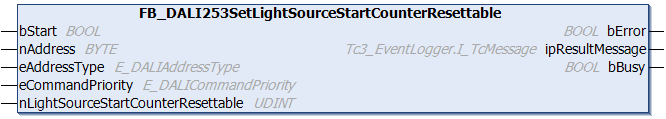

The function block sets the resettable counter for the switching on of the light source to any desired value. The resettable counter is incremented by one each time the light source changes from the Off state to the On state.
The resettable counter can be read using the function block FB_DALI253QueryLightSourceStartCounterResettable.
FB_DALI253SetLightSourceStartCounterResettable 2: Inputs
  bStart                             : BOOL;
  nAddress                           : BYTE;
  eAddressType                       : E_DALIAddressType := E_DALIAddressType.Short;
  eCommandPriority                   : E_DALICommandPriority := E_DALICommandPriority.MiddleLow;
  nLightSourceStartCounterResettable : UDINT;

FB_DALI253SetLightSourceStartCounterResettable 3:
Type
UDINT
New value of the resettable counter for the switching on of the light source (0...16777213)
FB_DALI253SetLightSourceStartCounterResettable 4: Outputs
Type
ipResultMessage
I_TcMessage
bBusy
