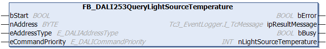

The function block indicates the temperature of the light source.
The output nLightSourceTemperature only contains a valid value if the function block was executed without errors (bError = FALSE).

  bStart            : BOOL;
  nAddress          : BYTE;
Type
bStart
nAddress
BYTE
eAddressType
E_DALIAddressType
eCommandPriority
E_DALICommandPriority
FB_DALI253QueryLightSourceTemperature 3:
FB_DALI253QueryLightSourceTemperature 4: Outputs
  bError                                 : BOOL;
  ipResultMessage                        : I_TcMessage;
  bBusy                                  : BOOL;
  nLightSourceTemperature                : INT;
Type
ipResultMessage
I_TcMessage
bBusy
INT
Temperature of the light source [°C] (-60…193)
