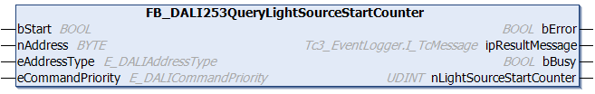

FB_DALI253QueryLightSourceStartCounter 1:
The function block reads the non-resettable counter for the switching on of the light source. The non-resettable counter is incremented by one each time the light source changes from the Off state to the On state. The non-resettable counter cannot be reset or changed.
The output nLightSourceStartCounter contains a valid value only if the function block was executed without errors (bError = FALSE).
FB_DALI253QueryLightSourceStartCounter 2: Inputs
  bStart            : BOOL;
  nAddress          : BYTE;
Type
bStart
nAddress
BYTE
eAddressType
E_DALIAddressType
eCommandPriority
E_DALICommandPriority
FB_DALI253QueryLightSourceStartCounter 3:
FB_DALI253QueryLightSourceStartCounter 4: Outputs
  bError                                 : BOOL;
  ipResultMessage                        : I_TcMessage;
  bBusy                                  : BOOL;
  nLightSourceStartCounter               : UDINT;
Type
ipResultMessage
I_TcMessage
bBusy
Current value of the non-resettable counter for the switching on of the light source (0...16777213).
