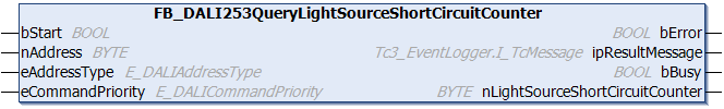

FB_DALI253QueryLightSourceShortCircuitCounter 1:
The function block reads the counter that counts the number of light source short-circuits.
The output nLightSourceShortCircuitCounter only contains a valid value if the function block was executed without errors (bError = FALSE).
FB_DALI253QueryLightSourceShortCircuitCounter 2: Inputs
  bStart            : BOOL;
  nAddress          : BYTE;
Type
bStart
nAddress
BYTE
eAddressType
E_DALIAddressType
eCommandPriority
E_DALICommandPriority

FB_DALI253QueryLightSourceShortCircuitCounter 4: Outputs
  bError                                 : BOOL;
  ipResultMessage                        : I_TcMessage;
  bBusy                                  : BOOL;
  nLightSourceShortCircuitCounter        : USINT;
Type
ipResultMessage
I_TcMessage
bBusy
USINT
Number of short circuits that have occurred (0…253)
