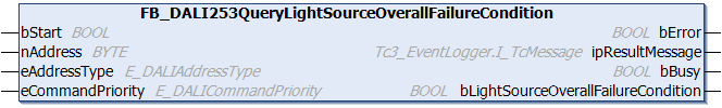

The function block outputs the status of lampFailure at the DALI control gear.
The output bLightSourceOverallFailureCondition contains a valid value only if the function block was executed without errors (bError = FALSE).

The output is set as soon as a light source error has been detected in the DALI control gear.
