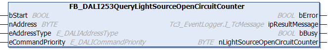

FB_DALI253QueryLightSourceOpenCircuitCounter 1:
The function block reads the counter of the number of open circuits to the light source.
The output nLightSourceOpenCircuitCounter only contains a valid value if the function block was executed without errors (bError = FALSE).
FB_DALI253QueryLightSourceOpenCircuitCounter 2: Inputs
  bStart            : BOOL;
  nAddress          : BYTE;
Type
bStart
nAddress
BYTE
eAddressType
E_DALIAddressType
eCommandPriority
E_DALICommandPriority
FB_DALI253QueryLightSourceOpenCircuitCounter 3:
FB_DALI253QueryLightSourceOpenCircuitCounter 4: Outputs
  bError                                 : BOOL;
  ipResultMessage                        : I_TcMessage;
  bBusy                                  : BOOL;
  nLightSourceOpenCircuitCounter         : USINT;
Type
ipResultMessage
I_TcMessage
bBusy
USINT
Number of open-circuit events (0…253)
