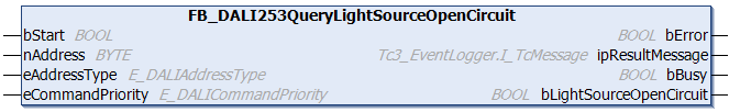

FB_DALI253QueryLightSourceOpenCircuit
FB_DALI253QueryLightSourceOpenCircuit 1:
The function block indicates whether there is an open circuit to the light source.
The output bLightSourceOpenCircuit contains a valid value only if the function block was executed without errors (bError = FALSE).
FB_DALI253QueryLightSourceOpenCircuit 2: Inputs
  bStart            : BOOL;
  nAddress          : BYTE;
Type
bStart
nAddress
BYTE
eAddressType
E_DALIAddressType
eCommandPriority
E_DALICommandPriority
FB_DALI253QueryLightSourceOpenCircuit 3:
FB_DALI253QueryLightSourceOpenCircuit 4: Outputs
  bError                                 : BOOL;
  ipResultMessage                        : I_TcMessage;
  bBusy                                  : BOOL;
  bLightSourceOpenCircuit                : BOOL;
Type
ipResultMessage
I_TcMessage
bBusy
The output is set as soon as an open circuit to the light source is detected.
FB_DALI253QueryLightSourceOpenCircuit 5: Properties
Type
Access
Initial value
ipDALICommunication
I_DALICommunication
Get, Set
NULL
Requirements
Development environment
Required PLC library
TwinCAT from v3.1.4024.10
Tc3_DALI from v3.4.0.0
