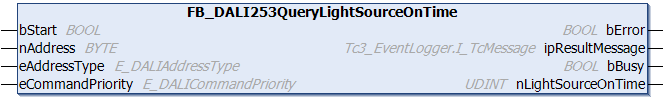

The function block reads the non-resettable operating hour counter of the light source. If the light source is switched on, the non-resettable operating hour counter is incremented by one every second.
The non-resettable operating hour counter cannot be reset or changed.
The output nLightSourceOnTime contains a valid value only if the function block was executed without errors (bError = FALSE).
FB_DALI253QueryLightSourceOnTime 2: Inputs
  bStart            : BOOL;
  nAddress          : BYTE;
Type
bStart
nAddress
BYTE
eAddressType
E_DALIAddressType
eCommandPriority
E_DALICommandPriority

FB_DALI253QueryLightSourceOnTime 4: Outputs
  bError                                 : BOOL;
  ipResultMessage                        : I_TcMessage;
  bBusy                                  : BOOL;
  nLightSourceOnTime                     : UDINT;
Type
ipResultMessage
I_TcMessage
bBusy
nLightSourceOnTime
UDINT
Current value of the non-resettable operating hours counter [s] (0…4294967293)
