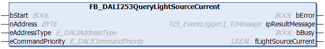

FB_DALI253QueryLightSourceCurrent
The function block reads the current consumption of the light source.
The output fLightSourceCurrent contains a valid value only if the function block was executed without errors (bError = FALSE).
Inputs
bStart : BOOL;
nAddress : BYTE;
Outputs
bError : BOOL;
bBusy : BOOL;
fLightSourceCurrent : LREAL;
bBusy | BOOL | The output is set as soon as execution of the DALI commands has commenced. It remains active until all DALI commands have been processed. For some errors (e.g. faulty parameters), bError is set immediately after the positive edge at bStart without bBusy switching to TRUE. |
fLightSourceCurrent | LREAL | Current consumption [A] (0.0…65.533) |
