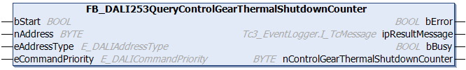

FB_DALI253QueryControlGearThermalShutdownCounter
FB_DALI253QueryControlGearThermalShutdownCounter 1:
The function block reads the counter of the number of thermal shutdowns of the DALI control gear.
The output nControlGearThermalShutdownCounter only contains a valid value if the function block was executed without errors (bError = FALSE).
FB_DALI253QueryControlGearThermalShutdownCounter 2: Inputs

FB_DALI253QueryControlGearThermalShutdownCounter 3:
FB_DALI253QueryControlGearThermalShutdownCounter 4: Outputs
  bError                                 : BOOL;
  ipResultMessage                        : I_TcMessage;
  bBusy                                  : BOOL;
  nControlGearThermalShutdownCounter     : USINT;

Number of thermal shutdowns (0…253)
