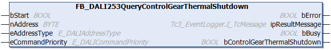

FB_DALI253QueryControlGearThermalShutdown 1:
The function block indicates whether there is a thermal shutdown of the DALI control gear.
The output bControlGearThermalShutdown only contains a valid value if the function block was executed without errors (bError = FALSE).
FB_DALI253QueryControlGearThermalShutdown 2: Inputs
  bStart            : BOOL;
  nAddress          : BYTE;
Type
bStart
nAddress
BYTE
eAddressType
E_DALIAddressType
eCommandPriority
E_DALICommandPriority
FB_DALI253QueryControlGearThermalShutdown 3:
FB_DALI253QueryControlGearThermalShutdown 4: Outputs
  bError                                 : BOOL;
  ipResultMessage                        : I_TcMessage;
  bBusy                                  : BOOL;
  bControlGearThermalShutdown            : BOOL;
Type
ipResultMessage
I_TcMessage
bBusy
The output is set as soon as the condition for a thermal shutdown of the DALI control gear is satisfied.
