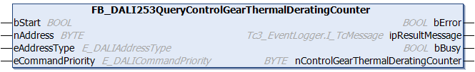

FB_DALI253QueryControlGearThermalDeratingCounter
The function block reads the counter that counts the number of times the temperature limit value inside the DALI control gear is exceeded.
The output nControlGearThermalDeratingCounter only contains a valid value if the function block was executed without errors (bError = FALSE).
Inputs
bStart : BOOL;
nAddress : BYTE;
Outputs
bError : BOOL;
bBusy : BOOL;
nControlGearThermalDeratingCounter : BYTE;
bBusy | BOOL | The output is set as soon as execution of the DALI commands has commenced. It remains active until all DALI commands have been processed. For some errors (e.g. faulty parameters), bError is set immediately after the positive edge at bStart without bBusy switching to TRUE. |
nControlGearThermalDeratingCounter | BYTE | Number of times the internal temperature was exceeded (0…253) |
