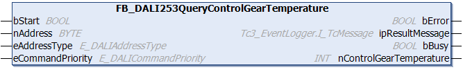

FB_DALI253QueryControlGearTemperature
The function block outputs the internal temperature of the DALI control gear.
The output nControlGearTemperature only contains a valid value if the function block was executed without errors (bError = FALSE).

bBusy | BOOL | The output is set as soon as execution of the DALI commands has commenced. It remains active until all DALI commands have been processed. For some errors (e.g. faulty parameters), bError is set immediately after the positive edge at bStart without bBusy switching to TRUE. |
nControlGearTemperature | INT | Internal temperature [°C] (-60…193) |
