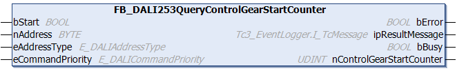

FB_DALI253QueryControlGearStartCounter
FB_DALI253QueryControlGearStartCounter 1:
The function block outputs the number of starts of the DALI control gear. The value is incremented after switching on the external power supply.
The output nControlGearStartCounter only contains a valid value if the function block was executed without errors (bError = FALSE).
FB_DALI253QueryControlGearStartCounter 2: Inputs
  bStart            : BOOL;
  nAddress          : BYTE;
Type
bStart
nAddress
BYTE
eAddressType
E_DALIAddressType
eCommandPriority
E_DALICommandPriority
FB_DALI253QueryControlGearStartCounter 3:
FB_DALI253QueryControlGearStartCounter 4: Outputs
  bError                                 : BOOL;
  ipResultMessage                        : I_TcMessage;
  bBusy                                  : BOOL;
  nControlGearStartCounter               : UDINT;
Type
ipResultMessage
I_TcMessage
bBusy
UDINT
Number of starts of the DALI control gear (0…16777213).
FB_DALI253QueryControlGearStartCounter 5: Properties
Type
Access
Initial value
ipDALICommunication
I_DALICommunication
Get, Set
NULL
Requirements
Development environment
Required PLC library
TwinCAT from v3.1.4024.10
Tc3_DALI from v3.4.0.0
