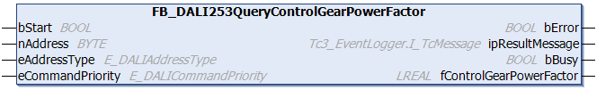

The function block outputs the power factor of the DALI control gear.
The output fControlGearPowerFactor contains a valid value only if the function block was executed without errors (bError = FALSE).
FB_DALI253QueryControlGearPowerFactor 2: Inputs
  bStart            : BOOL;
  nAddress          : BYTE;
Type
bStart
nAddress
BYTE
eAddressType
E_DALIAddressType
eCommandPriority
E_DALICommandPriority
FB_DALI253QueryControlGearPowerFactor 3:
FB_DALI253QueryControlGearPowerFactor 4: Outputs
  bError                                 : BOOL;
  ipResultMessage                        : I_TcMessage;
  bBusy                                  : BOOL;
  fControlGearPowerFactor                : LREAL;
Type
ipResultMessage
I_TcMessage
bBusy
LREAL
Power factor (0.0…1.0)
