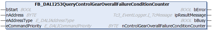

The function block reads the counter of the error events that have occurred in the DALI control gear.
The output nControlGearOverallFailureConditionCounter contains a valid value only if the function block was executed without errors (bError = FALSE).

FB_DALI253QueryControlGearOverallFailureConditionCounter 4: Outputs
  bError                                    : BOOL;
  ipResultMessage                           : I_TcMessage;
  bBusy                                     : BOOL;
  nControlGearOverallFailureConditionCounter: USINT;
Type
ipResultMessage
I_TcMessage
bBusy
USINT
Number of errors detected (0…253).
