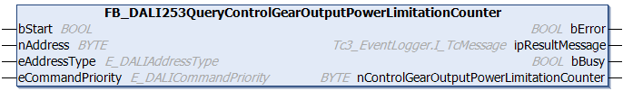

The function block reads the counter of the number of exceedances of the output power limit value at the DALI control gear.
The output nControlGearOutputPowerLimitationCounter only contains a valid value if the function block was executed without errors (bError = FALSE).
FB_DALI253QueryControlGearOutputPowerLimitationCounter 2: Inputs
  bStart            : BOOL;
  nAddress          : BYTE;
Type
bStart
nAddress
BYTE
eAddressType
E_DALIAddressType
eCommandPriority
E_DALICommandPriority
FB_DALI253QueryControlGearOutputPowerLimitationCounter 3:
FB_DALI253QueryControlGearOutputPowerLimitationCounter 4: Outputs
  bError                                    : BOOL;
  ipResultMessage                           : I_TcMessage;
  bBusy                                     : BOOL;
  nControlGearOutputPowerLimitationCounter  : USINT;
Type
ipResultMessage
I_TcMessage
bBusy
USINT
Number of output-power limit exceedances (0…253).
