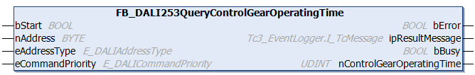

FB_DALI253QueryControlGearOperatingTime 1:
The function block reads the operating time of the DALI control gear.
The output nControlGearOperatingTime only contains a valid value if the function block was executed without errors (bError = FALSE).
FB_DALI253QueryControlGearOperatingTime 2: Inputs
  bStart            : BOOL;
  nAddress          : BYTE;
Type
bStart
nAddress
BYTE
eAddressType
E_DALIAddressType
eCommandPriority
E_DALICommandPriority
FB_DALI253QueryControlGearOperatingTime 3:
FB_DALI253QueryControlGearOperatingTime 4: Outputs
  bError                                 : BOOL;
  ipResultMessage                        : I_TcMessage;
  bBusy                                  : BOOL;
  nControlGearOperatingTime              : UDINT;
Type
ipResultMessage
I_TcMessage
bBusy
UDINT
Operating time [s] (0…4294967293)
