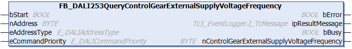

FB_DALI253QueryControlGearExternalSupplyVoltageFrequency 1:
The function block reads the frequency of the external supply voltage from the DALI control gear.
The output fControlGearExternalSupplyVoltageFrequency only contains a valid value if the function block was executed without errors (bError = FALSE).
FB_DALI253QueryControlGearExternalSupplyVoltageFrequency 2: Inputs
  bStart            : BOOL;
  nAddress          : BYTE;
Type
bStart
nAddress
BYTE
eAddressType
E_DALIAddressType
eCommandPriority
E_DALICommandPriority
FB_DALI253QueryControlGearExternalSupplyVoltageFrequency 3:
FB_DALI253QueryControlGearExternalSupplyVoltageFrequency 4: Outputs
  bError                                      : BOOL;
  ipResultMessage                             : I_TcMessage;
  bBusy                                       : BOOL;
  fControlGearExternalSupplyVoltageFrequency  : USINT;
Type
ipResultMessage
I_TcMessage
bBusy
USINT
Frequency of the external supply voltage [Hz] (0…253).
