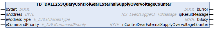

The function block reads the counter for the detected overvoltage events of the external supply voltage of the DALI control gear.
The output nControlGearExternalSupplyOvervoltageCounter only contains a valid value if the function block was executed without errors (bError = FALSE).
FB_DALI253QueryControlGearExternalSupplyOvervoltageCounter 2: Inputs
  bStart            : BOOL;
  nAddress          : BYTE;
Type
bStart
nAddress
BYTE
eAddressType
E_DALIAddressType
eCommandPriority
E_DALICommandPriority
FB_DALI253QueryControlGearExternalSupplyOvervoltageCounter 3:
FB_DALI253QueryControlGearExternalSupplyOvervoltageCounter 4: Outputs
  bError                                        : BOOL;
  ipResultMessage                               : I_TcMessage;
  bBusy                                         : BOOL;
  nControlGearExternalSupplyOvervoltageCounter  : BYTE;
Type
ipResultMessage
I_TcMessage
bBusy
BYTE
Number of detected overvoltage events of the external supply voltage (0...253).
