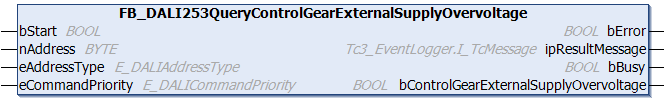

FB_DALI253QueryControlGearExternalSupplyOvervoltage
FB_DALI253QueryControlGearExternalSupplyOvervoltage 1:
The function block indicates whether an overvoltage has been detected in the external supply voltage of the DALI control gear.
The output bControlGearExternalSupplyOvervoltage only contains a valid value if the function block was executed without errors (bError = FALSE).
FB_DALI253QueryControlGearExternalSupplyOvervoltage 2: Inputs
  bStart            : BOOL;
  nAddress          : BYTE;
Type
bStart
nAddress
BYTE
eAddressType
E_DALIAddressType
eCommandPriority
E_DALICommandPriority
FB_DALI253QueryControlGearExternalSupplyOvervoltage 3:
FB_DALI253QueryControlGearExternalSupplyOvervoltage 4: Outputs
  bError                                 : BOOL;
  ipResultMessage                        : I_TcMessage;
  bBusy                                  : BOOL;
  bControlGearExternalSupplyOvervoltage  : BOOL;
Type
ipResultMessage
I_TcMessage
bBusy
The output is set as soon as an overvoltage has been detected in the external supply voltage of the DALI control gear.
