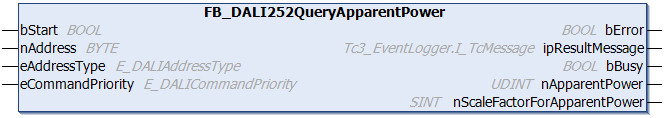

FB_DALI252QueryApparentPower
FB_DALI252QueryApparentPower 1:
The function block reads the apparent power from the DALI control gear.
It is calculated as follows:
FB_DALI252QueryApparentPower 2:
The outputs nApparentPower and nScaleFactorForApparentPower only contain a valid value if the function block was executed without errors (bError = FALSE).
FB_DALI252QueryApparentPower 3: Inputs
  bStart            : BOOL;
  nAddress          : BYTE;
Type
bStart
nAddress
BYTE
eAddressType
E_DALIAddressType
eCommandPriority
E_DALICommandPriority
FB_DALI252QueryApparentPower 4:
FB_DALI252QueryApparentPower 5: Outputs
  bError                       : BOOL;
  ipResultMessage              : I_TcMessage;
  bBusy                        : BOOL;
  nApparentPower               : UDINT;
  nScaleFactorForApparentPower : SINT;
Type
ipResultMessage
I_TcMessage
bBusy
nApparentPower
ULINT
Apparent power [VA] (0…4294967293).
SINT
Scaling factor for the apparent power (-6...6).
FB_DALI252QueryApparentPower 6: Properties
Type
Access
Initial value
ipDALICommunication
I_DALICommunication
Get,Set
0
Requirements
Development environment
Required PLC library
TwinCAT from v3.1.4024.10
Tc3_DALI from v3.4.0.0
