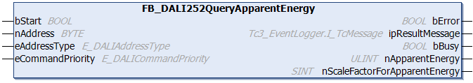

FB_DALI252QueryApparentEnergy 3: Inputs
  bStart            : BOOL;
  nAddress          : BYTE;
Type
bStart
nAddress
BYTE
eAddressType
E_DALIAddressType
eCommandPriority
E_DALICommandPriority
FB_DALI252QueryApparentEnergy 4:
FB_DALI252QueryApparentEnergy 5: Outputs
  bError                       : BOOL;
  ipResultMessage              : I_TcMessage;
  bBusy                        : BOOL;
  nApparentEnergy              : ULINT;
  nScaleFactorForApparentEnergy: SINT;
Type
ipResultMessage
I_TcMessage
bBusy
nApparentEnergy
ULINT
Apparent energy [VAh] (0…281474976710653).
SINT
Scaling factor for the apparent energy (-6...6).
