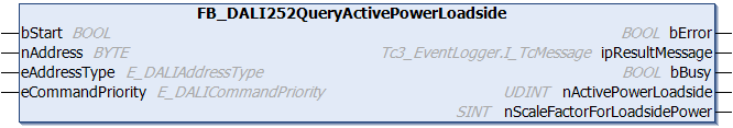

The function block reads the load-side active power from the DALI control gear.
It is calculated as follows:
The outputs nActivePowerLoadside and nScaleFactorForLoadsidePower only contain a valid value if the function block was executed without errors (bError = FALSE).
Inputs
bStart : BOOL;
nAddress : BYTE;
Outputs
bError : BOOL;
bBusy : BOOL;
nActivePowerLoadside : UDINT;
nScaleFactorForLoadsidePower : SINT;
bBusy | BOOL | The output is set as soon as execution of the DALI commands has commenced. It remains active until all DALI commands have been processed. For some errors (e.g. faulty parameters), bError is set immediately after the positive edge at bStart without bBusy switching to TRUE. |
nActivePowerLoadside | UDINT | Load-side active power [W] (0…4294967293). |
nScaleFactorForLoadsidePower | SINT | Scaling factor for the load-side active power (-6...6). |
