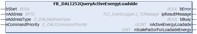

The function block reads the load-side active energy from the DALI control gear.
It is calculated as follows:
FB_DALI252QueryActiveEnergyLoadside 2:
The outputs nActiveEnergyLoadside and nScaleFactorForLoadsideEnergy only contain a valid value if the function block was executed without errors (bError = FALSE).
FB_DALI252QueryActiveEnergyLoadside 3: Inputs
  bStart            : BOOL;
  nAddress          : BYTE;
Type
bStart
nAddress
BYTE
eAddressType
E_DALIAddressType
eCommandPriority
E_DALICommandPriority
FB_DALI252QueryActiveEnergyLoadside 4:
FB_DALI252QueryActiveEnergyLoadside 5: Outputs
  bError                       : BOOL;
  ipResultMessage              : I_TcMessage;
  bBusy                        : BOOL;
  nActiveEnergyLoadside        : ULINT;
  nScaleFactorForLoadsideEnergy: SINT;
Type
ipResultMessage
I_TcMessage
bBusy
ULINT
Load-side active energy [Wh] (0…281474976710653).
SINT
Scaling factor for the load-side active energy (-6...6).
