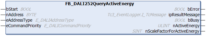

The function block reads the active energy from the DALI control gear.
It is calculated as follows:
The outputs nActiveEnergy and nScaleFactorForActiveEnergy only contain a valid value if the function block was executed without errors (bError = FALSE).

bBusy | BOOL | The output is set as soon as execution of the DALI commands has commenced. It remains active until all DALI commands have been processed. For some errors (e.g. faulty parameters), bError is set immediately after the positive edge at bStart without bBusy switching to TRUE. |
nActiveEnergy
| ULINT | Active energy [Wh] (0…281474976710653). |
nScaleFactorForActiveEnergy | SINT | Scaling factor for the active energy (-6...6). |
