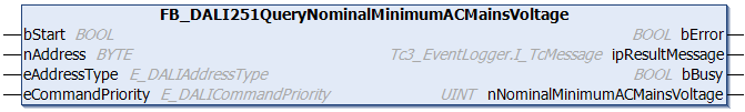

The function block reads the minimum nominal input voltage of the DALI control gear.
The output nNominalMinimumACMainsVoltage only contains a valid value if the function block was executed without errors (bError = FALSE).
FB_DALI251QueryNominalMinimumACMainsVoltage 2: Inputs
  bStart            : BOOL;
  nAddress          : BYTE;
Type
bStart
nAddress
BYTE
eAddressType
E_DALIAddressType
eCommandPriority
E_DALICommandPriority
FB_DALI251QueryNominalMinimumACMainsVoltage 3:
FB_DALI251QueryNominalMinimumACMainsVoltage 4: Outputs
  bError                         : BOOL;
  ipResultMessage                : I_TcMessage;
  bBusy                          : BOOL;
  nNominalMinimumACMainsVoltage  : UINT;
Type
ipResultMessage
I_TcMessage
bBusy
UINT
Minimum nominal input voltage [V] (90…480).
