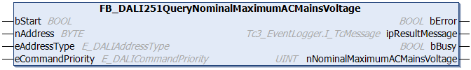

The function block reads the maximum nominal input voltage of the DALI control gear.
The output nNominalMaximumACMainsVoltage only contains a valid value if the function block was executed without errors (bError = FALSE).
FB_DALI251QueryNominalMaximumACMainsVoltage 2: Inputs
  bStart            : BOOL;
  nAddress          : BYTE;
Type
bStart
nAddress
BYTE
eAddressType
E_DALIAddressType
eCommandPriority
E_DALICommandPriority
FB_DALI251QueryNominalMaximumACMainsVoltage 3:
FB_DALI251QueryNominalMaximumACMainsVoltage 4: Outputs
  bError                         : BOOL;
  ipResultMessage                : I_TcMessage;
  bBusy                          : BOOL;
  nNominalMaximumACMainsVoltage  : UINT;
Type
ipResultMessage
I_TcMessage
bBusy
UINT
Maximum nominal input voltage [V] (90…480).
