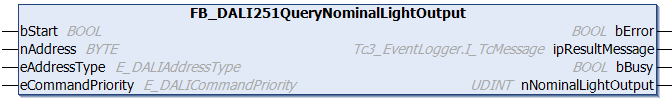

The function block reads the nominal light output of the luminaire from the DALI control gear.
The output nNominalLightOutput contains a valid value only if the function block was executed without errors (bError = FALSE).
FB_DALI251QueryNominalLightOutput 2: Inputs
  bStart            : BOOL;
  nAddress          : BYTE;
Type
bStart
nAddress
BYTE
eAddressType
E_DALIAddressType
eCommandPriority
E_DALICommandPriority

FB_DALI251QueryNominalLightOutput 4: Outputs
  nNominalLightOutput     : UDINT;
Type
ipResultMessage
I_TcMessage
bBusy
nNominalLightOutput
UDINT
Nominal illuminance [Lm] (0…16777214).
