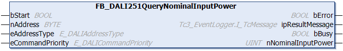

FB_DALI251QueryNominalInputPower
FB_DALI251QueryNominalInputPower 1:
The function block reads the nominal input power of the luminaire from the DALI control gear.
The output nNominalInputPower contains a valid value only if the function block was executed without errors (bError = FALSE).
FB_DALI251QueryNominalInputPower 2: Inputs
  bStart            : BOOL;
  nAddress          : BYTE;
Type
bStart
nAddress
BYTE
eAddressType
E_DALIAddressType
eCommandPriority
E_DALICommandPriority
FB_DALI251QueryNominalInputPower 3:
FB_DALI251QueryNominalInputPower 4: Outputs
  nNominalInputPower      : UINT;
Type
ipResultMessage
I_TcMessage
bBusy
nNominalInputPower
UINT
Nominal output [W] (0…65534).
