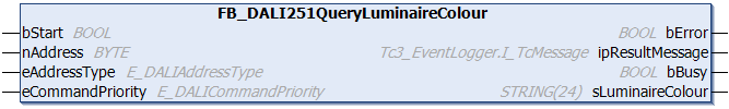

FB_DALI251QueryLuminaireColour
The function block reads the luminaire color from the DALI control gear.
The output sLuminaireColour contains a valid value only if the function block was executed without errors (bError = FALSE).
Inputs
bStart : BOOL;
nAddress : BYTE;
Outputs
bError : BOOL;
bBusy : BOOL;
sLuminaireColour : STRING(24);
bBusy | BOOL | The output is set as soon as execution of the DALI commands has commenced. It remains active until all DALI commands have been processed. |
sLuminaireColour | STRING | Outputs the luminaire color. |
