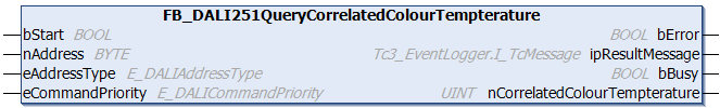

The function block reads the correlated color temperature from the DALI control gear.
The output nCorrelatedColourTemperature only contains a valid value if the function block was executed without errors (bError = FALSE).
FB_DALI251QueryCorrelatedColourTemperature 2: Inputs
  bStart            : BOOL;
  nAddress          : BYTE;
Type
bStart
nAddress
BYTE
eAddressType
E_DALIAddressType
eCommandPriority
E_DALICommandPriority
FB_DALI251QueryCorrelatedColourTemperature 3:
FB_DALI251QueryCorrelatedColourTemperature 4: Outputs
  bError                        : BOOL;
  ipResultMessage               : I_TcMessage;
  bBusy                         : BOOL;
  nCorrelatedColourTemperature  : UINT;
Type
ipResultMessage
I_TcMessage
bBusy
UINT
Outputs the correlated color temperature [K] (0…17000). If the value 16#FFFE is returned, then Part 209 is not implemented in the DALI control gear.
