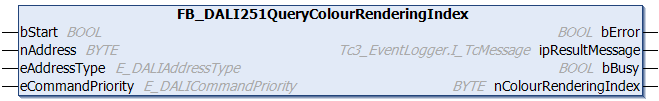

The function block reads the color rendering index from the DALI control gear.
The output nColourRenderingIndex contains a valid value only if the function block was executed without errors (bError = FALSE).

  nColourRenderingIndex   : USINT;
Type
ipResultMessage
I_TcMessage
bBusy
USINT
Outputs the color rendering index (0…100).
