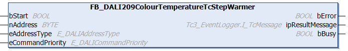

FB_DALI209ColourTemperatureTcStepWarmer
Due to the function block the value colourTemperatureTc is increased by 1 Mirek without cross-fading. If the colourTemperatureTc value already has the same value as colourTemperatureTcWarmest, no change takes place.
Bit 1 (Colour temperature Tc out of range) is set in colourStatus if the color temperature cannot be reached by the DALI control gear. This command is executed by the DALI control gear only if bit 5 (Colour type color temperature Tc active) is set in the variable colourStatus.
The functions KELVIN_TO_MIREK and MIREK_TO_KELVIN are available for converting from or to Kelvin.
