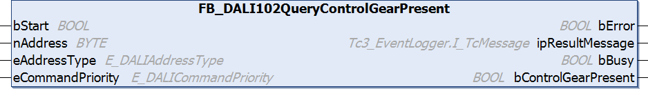

The function block indicates whether the required DALI control gear can be reached via its short address.
The output bControlGearPresent contains a valid value only if the function block was executed without errors (bError = FALSE).

  bStart            : BOOL;
  nAddress          : BYTE;
Type
bStart
nAddress
BYTE
eAddressType
E_DALIAddressType
eCommandPriority
E_DALICommandPriority

  bControlGearPresent     : BOOL;
Type
ipResultMessage
I_TcMessage
bBusy
bControlGearPesent
The output is set as soon as the queried DALI control gear is available.
