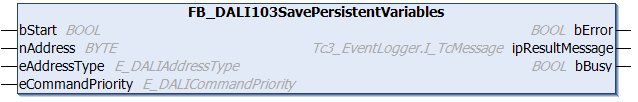

FB_DALI103SavePersistentVariables
FB_DALI103SavePersistentVariables 1:
The function block immediately triggers the saving of variables in the persistent memory by the DALI command SAVE PRESISTENT VARIABLES.
DALI control devices do not save the variables directly in the persistent memory. Instead, the values are copied to the persistent memory in the background. Since this happens over a longer period of time (a few seconds), the values can be lost if the DALI bus is disconnected.
The SAVE PRESISTENT VARIABLES DALI command triggers immediate copying to the persistent memory. In most cases, no communication with the DALI device can take place during copying (up to 350 ms).
FB_DALI103SavePersistentVariables 2:
The function block sends the DALI command SAVE PRESISTENT VARIABLES twice, as required by the DALI standard for certain DALI commands.
FB_DALI103SavePersistentVariables 3:
FB_DALI103SavePersistentVariables 4: Inputs
  bStart            : BOOL;
  nAddress          : BYTE;
Type
bStart
nAddress
BYTE
Address of a DALI control device or a DALI group.
eAddressType
E_DALIAddressType
Defines whether the input nAddress contains a short address (0…63) or a group address (0…31). The input nAddress has no meaning if a broadcast or a broadcast to unaddressed devices (BroadcastUnaddr) has been selected.
eCommandPriority
E_DALICommandPriority
FB_DALI103SavePersistentVariables 5:
The command priorities are supported by the KL6821 from the firmware version BD.
FB_DALI103SavePersistentVariables 6: Outputs
Type
ipResultMessage
I_TcMessage
bBusy
FB_DALI103SavePersistentVariables 7: Properties
Type
Access
Initial value
ipDALICommunication
I_DALICommunication
Get, Set
NULL
