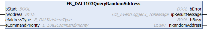

FB_DALI103QueryRandomAddress 1:
The function block reads the variable randomAddress from the DALI control device.
The DALI commands QUERY RANDOM ADDRESS (H), QUERY RANDOM ADDRESS (M) and QUERY RANDOM ADDRESS (L) are called internally.
The output nRandomAddress contains a valid value only if the function block was executed without errors (bError = FALSE).

FB_DALI103QueryRandomAddress 3: Inputs
  bStart            : BOOL;
  nAddress          : BYTE;
Type
bStart
nAddress
BYTE
Address of a DALI control device or a DALI group.
eAddressType
E_DALIAddressType
Defines whether the input nAddress contains a short address (0…63) or a group address (0…31). The input nAddress has no meaning if a broadcast or a broadcast to unaddressed devices (BroadcastUnaddr) has been selected.

FB_DALI103QueryRandomAddress 5: Outputs
  nRandomAddress          : UDINT;
Type
ipResultMessage
I_TcMessage
bBusy
nRandomAddress
UDINT
Random address (16#00_00_00…16#FF_FF_FE).
