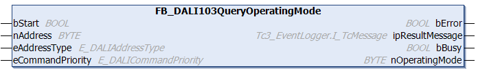

FB_DALI103QueryOperatigMode
FB_DALI103QueryOperatigMode 1:
The function block reads the variable operatingMode from the DALI control device.
The meaning of this variable is defined by the manufacturer of the DALI control device.
The output nOperatingMode only contains a valid value if the function block was executed without errors (bError = FALSE).

FB_DALI103QueryOperatigMode 3: Inputs
  bStart            : BOOL;
  nAddress          : BYTE;
Type
bStart
nAddress
BYTE
Address of a DALI control device or a DALI group.
eAddressType
E_DALIAddressType
Defines whether the input nAddress contains a short address (0…63) or a group address (0…31). The input nAddress has no meaning if a broadcast or a broadcast to unaddressed devices (BroadcastUnaddr) has been selected.
eCommandPriority
E_DALICommandPriority
FB_DALI103QueryOperatigMode 4:
The command priorities are supported by the KL6821 from the firmware version BD.
FB_DALI103QueryOperatigMode 5: Outputs
  nOperatingMode          : BYTE;
Type
ipResultMessage
I_TcMessage
bBusy
nOperatingMode
BYTE
Output of the variable operatingMode.
