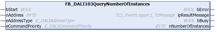

FB_DALI103QueryNumberOfInstances
FB_DALI103QueryNumberOfInstances 1:
The function block reads the number of existing instances from the DALI control device (see numberOfInstances).
The output nNumberOfInstances contains a valid value only if the function block was executed without errors (bError = FALSE).
FB_DALI103QueryNumberOfInstances 2:
FB_DALI103QueryNumberOfInstances 3: Inputs
  bStart            : BOOL;
  nAddress          : BYTE;
Type
bStart
nAddress
BYTE
Address of a DALI control device or a DALI group.
eAddressType
E_DALIAddressType
Defines whether the input nAddress contains a short address (0…63) or a group address (0…31). The input nAddress has no meaning if a broadcast or a broadcast to unaddressed devices (BroadcastUnaddr) has been selected.
eCommandPriority
E_DALICommandPriority
FB_DALI103QueryNumberOfInstances 4:
The command priorities are supported by the KL6821 from the firmware version BD.
FB_DALI103QueryNumberOfInstances 5: Outputs
  nNumberOfInstances      : BYTE;
Type
ipResultMessage
I_TcMessage
bBusy
nNumberOfInstances
DALI
Number of instances in the DALI control device.
FB_DALI103QueryNumberOfInstances 6: Properties
Type
Access
Initial value
ipDALICommunication
I_DALICommunication
Get, Set
NULL
Requirements
Development environment
required PLC library
TwinCAT from v3.1.4022.29
Tc3_DALI from v3.1.4.0
