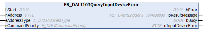

FB_DALI103QueryInputDeviceError
FB_DALI103QueryInputDeviceError 1:
The function block reads more detailed error information from the DALI control device (see inputDeviceError).
The meaning depends on the manufacturer of the DALI control device.
The output nInputDeviceError only contains a valid value if the function block was executed without errors (bError = FALSE).
FB_DALI103QueryInputDeviceError 2:
FB_DALI103QueryInputDeviceError 3: Inputs
  bStart            : BOOL;
  nAddress          : BYTE;
Type
bStart
nAddress
BYTE
Address of a DALI control device or a DALI group.
eAddressType
E_DALIAddressType
Defines whether the input nAddress contains a short address (0…63) or a group address (0…31). The input nAddress has no meaning if a broadcast or a broadcast to unaddressed devices (BroadcastUnaddr) has been selected.
eCommandPriority
E_DALICommandPriority
FB_DALI103QueryInputDeviceError 4:
The command priorities are supported by the KL6821 from the firmware version BD.
FB_DALI103QueryInputDeviceError 5: Outputs
  nInputDeviceError       : BYTE;
Type
ipResultMessage
I_TcMessage
bBusy
nInputDeviceError
BYTE
Output of the error information of the DALI control device (vendor-dependent).
FB_DALI103QueryInputDeviceError 6: Properties
Type
Access
Initial value
ipDALICommunication
I_DALICommunication
Get, Set
NULL
Requirements
Development environment
required PLC library
TwinCAT from v3.1.4022.29
Tc3_DALI from v3.1.4.0
