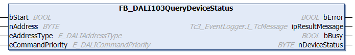

FB_DALI103QueryDeviceStatus
FB_DALI103QueryDeviceStatus 1:
The function block reads the status of the DALI control device.
The following status information is provided at output nDeviceStatus.
Bit
 0
Status of the DALI control device (see inputDeviceError)
 1
Quiescent mode (see quiescentMode)
 2
Short address missing (variable shortAddress is 255 (MASK))
 3
Application controller active (see applicationActive)
 4
Application controller error (see applicationControllerError)
 5
The power supply was enabled (see powerCycleSeen)
 6
Reset state (see resetState)
 7
Unused (default value is 0)
The output nDeviceStatus only contains a valid value if the function block was executed without errors (bError = FALSE).
FB_DALI103QueryDeviceStatus 2:
FB_DALI103QueryDeviceStatus 3: Inputs
  bStart            : BOOL;
  nAddress          : BYTE;
Type
bStart
nAddress
BYTE
Address of a DALI control device or a DALI group.
eAddressType
E_DALIAddressType
Defines whether the input nAddress contains a short address (0…63) or a group address (0…31). The input nAddress has no meaning if a broadcast or a broadcast to unaddressed devices (BroadcastUnaddr) has been selected.
eCommandPriority
E_DALICommandPriority
FB_DALI103QueryDeviceStatus 4:
The command priorities are supported by the KL6821 from the firmware version BD.
FB_DALI103QueryDeviceStatus 5: Outputs
  nDeviceStatus           : BYTE;
Type
ipResultMessage
I_TcMessage
bBusy
nDeviceStatus
BYTE
Output value of the Device Status, see table above.
