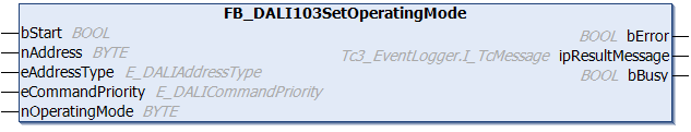

FB_DALI103SetOperatingMode
FB_DALI103SetOperatingMode 1:
The function block sets the operating mode of the DALI control device (see operatingMode).
FB_DALI103SetOperatingMode 2:
The function block changes the DTR0 of all connected DALI control devices.
FB_DALI103SetOperatingMode 3:
The function block sends the DALI command SET OPERATING MODE twice, as required by the DALI standard for certain DALI commands.
FB_DALI103SetOperatingMode 4:
FB_DALI103SetOperatingMode 5: Inputs
  bStart            : BOOL;
  nAddress          : BYTE;
  nOperatingMode    : BYTE := 0;
Type
bStart
nAddress
BYTE
Address of a DALI control device or a DALI group.
eAddressType
E_DALIAddressType
Defines whether the input nAddress contains a short address (0…63) or a group address (0…31). The input nAddress has no meaning if a broadcast or a broadcast to unaddressed devices (BroadcastUnaddr) has been selected.
eCommandPriority
E_DALICommandPriority
FB_DALI103SetOperatingMode 6:
The command priorities are supported by the KL6821 from the firmware version BD.
Type
nOperatingMode
BYTE
Operating mode entry
FB_DALI103SetOperatingMode 7: Outputs
Type
ipResultMessage
I_TcMessage
bBusy
FB_DALI103SetOperatingMode 8: Properties
Type
Access
Initial value
ipDALICommunication
I_DALICommunication
Get, Set
NULL
Requirements
Development environment
required PLC library
TwinCAT from v3.1.4022.29
