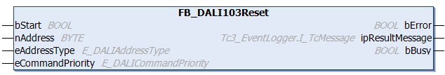

FB_DALI103Reset 1:
The function block resets all device and instance variables of the DALI control device to their reset values (see resetState).
DALI control devices can take up to 300 ms to execute the DALI command. Only then are further DALI commands executed by the respective control device.
FB_DALI103Reset 2:
The function block sends the DALI command RESET twice, as required by the DALI standard for certain DALI commands.

FB_DALI103Reset 4: Inputs
  bStart            : BOOL;
  nAddress          : BYTE;
Type
bStart
nAddress
BYTE
Address of a DALI control device or a DALI group.
eAddressType
E_DALIAddressType
Defines whether the input nAddress contains a short address (0…63) or a group address (0…31). The input nAddress has no meaning if a broadcast or a broadcast to unaddressed devices (BroadcastUnaddr) has been selected.

FB_DALI103Reset 6: Outputs
Type
ipResultMessage
I_TcMessage
bBusy
