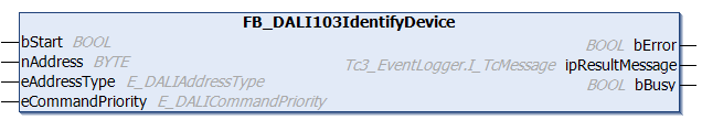

FB_DALI103IdentifyDevice
FB_DALI103IdentifyDevice 1:
The function block starts the identification routine for a DALI control device.
The routine takes approx. 10 s and ends automatically. The exact scope of the identification routine depends on the manufacturer of the DALI control device.
FB_DALI103IdentifyDevice 2:
The function block sends the DALI command IDENTIFY DEVICE twice, as required by the DALI standard for certain DALI commands.
FB_DALI103IdentifyDevice 3:
FB_DALI103IdentifyDevice 4: Inputs
  bStart            : BOOL;
  nAddress          : BYTE;
Type
bStart
nAddress
BYTE
eAddressType
E_DALIAddressType
Defines whether the input nAddress contains a short address (0…63) or a group address (0…31). The input nAddress has no meaning if a broadcast or a broadcast to unaddressed devices (BroadcastUnaddr) has been selected.
eCommandPriority
E_DALICommandPriority
FB_DALI103IdentifyDevice 5:
The command priorities are supported by the KL6821 from the firmware version BD.
