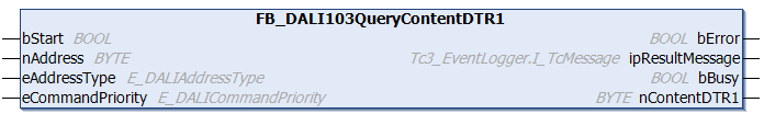

FB_DALI103QueryContentDTR1 1:
The function block reads the contents of DTR1 (Data Transfer Register 1) from the DALI control device.
The output nContentDTR1 contains a valid value only if the function block was executed without errors (bError = FALSE).
FB_DALI103QueryContentDTR1 2:
FB_DALI103QueryContentDTR1 3: Inputs
  bStart            : BOOL;
  nAddress          : BYTE;
Type
bStart
nAddress
BYTE
eAddressType
E_DALIAddressType
Defines whether the input nAddress contains a short address (0…63) or a group address (0…31). The input nAddress has no meaning if a broadcast or a broadcast to unaddressed devices (BroadcastUnaddr) has been selected.
eCommandPriority
E_DALICommandPriority
FB_DALI103QueryContentDTR1 4:
The command priorities are supported by the KL6821 from the firmware version BD.
FB_DALI103QueryContentDTR1 5: Outputs
  nContentDTR1            : BYTE;
Type
ipResultMessage
I_TcMessage
bBusy
nContentDTR1
BYTE
Content of the DTR1 (Data Transfer Register 1) (0…255)
