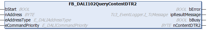

The function block reads the contents of DTR2 (Data Transfer Register 2) from the DALI control gear.
The output nContentDTR2 contains a valid value only if the function block was executed without errors (bError = FALSE).
Inputs
bStart : BOOL;
nAddress : BYTE;
Outputs
bError : BOOL;
bBusy : BOOL;
nContentDTR2 : BYTE;
bBusy | BOOL | The output is set as soon as execution of the DALI commands has commenced. It remains active until all DALI commands have been processed. |
nContentDTR2 | BYTE | Content of the DTR2 (Data Transfer Register 1) (0…255). |
